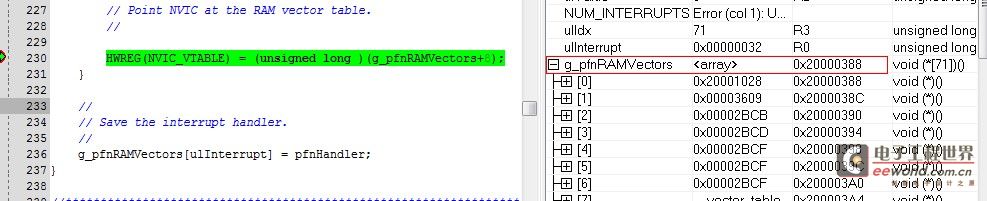

lm3s 把中断放在ram中,对NVIC_VTABLE赋值时错误
已有 954 次阅读2012-7-13 15:06
[code]void
IntRegister(unsigned long ulInterrupt, void (*pfnHandler)(void))
unsigned long ulIdx, ulValue;
// Check the arguments.
ASSERT(ulInterrupt < NUM_INTERRUPTS);
// Make sure that the RAM vector table is correctly aligned.
ASSERT(((unsigned long)g_pfnRAMVectors & 0x000003ff) == 0);
// See if the RAM vector table has been initialized.
if(HWREG(NVIC_VTABLE) != (unsigned long)g_pfnRAMVectors)
// Copy the vector table from the beginning of FLASH to the RAM vector
// table.
ulValue = HWREG(NVIC_VTABLE);
for(ulIdx = 0; ulIdx < NUM_INTERRUPTS; ulIdx++)
g_pfnRAMVectors[ulIdx] = (void (*)(void))HWREG((ulIdx * 4) +
ulValue);
// Point NVIC at the RAM vector table.
HWREG(NVIC_VTABLE) = (unsigned long )(g_pfnRAMVectors+8);
// Save the interrupt handler.
g_pfnRAMVectors[ulInterrupt] = pfnHandler;
}[/code]
上面是函数 那个+8是我自己加上的,加和不加都一样,NVIC_VTABLE始终是20000380.
为什么
